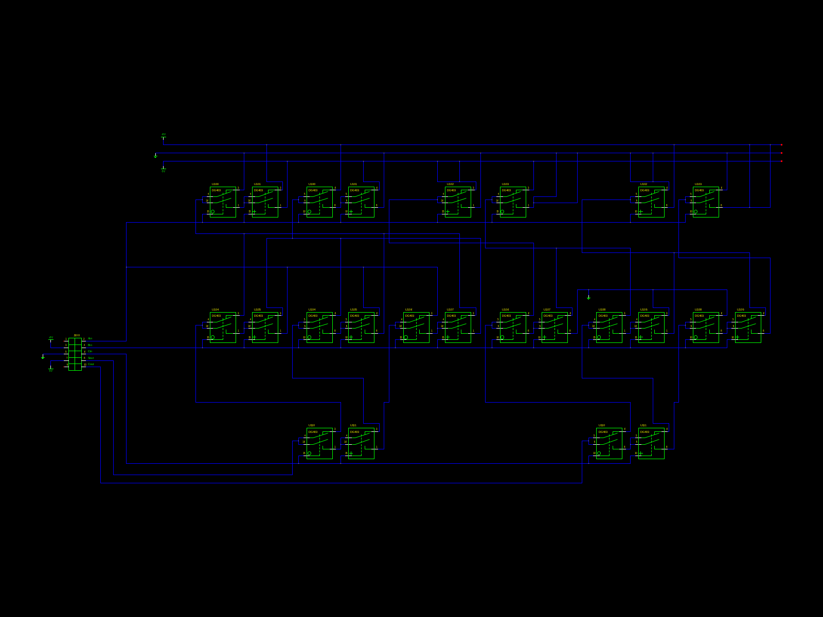

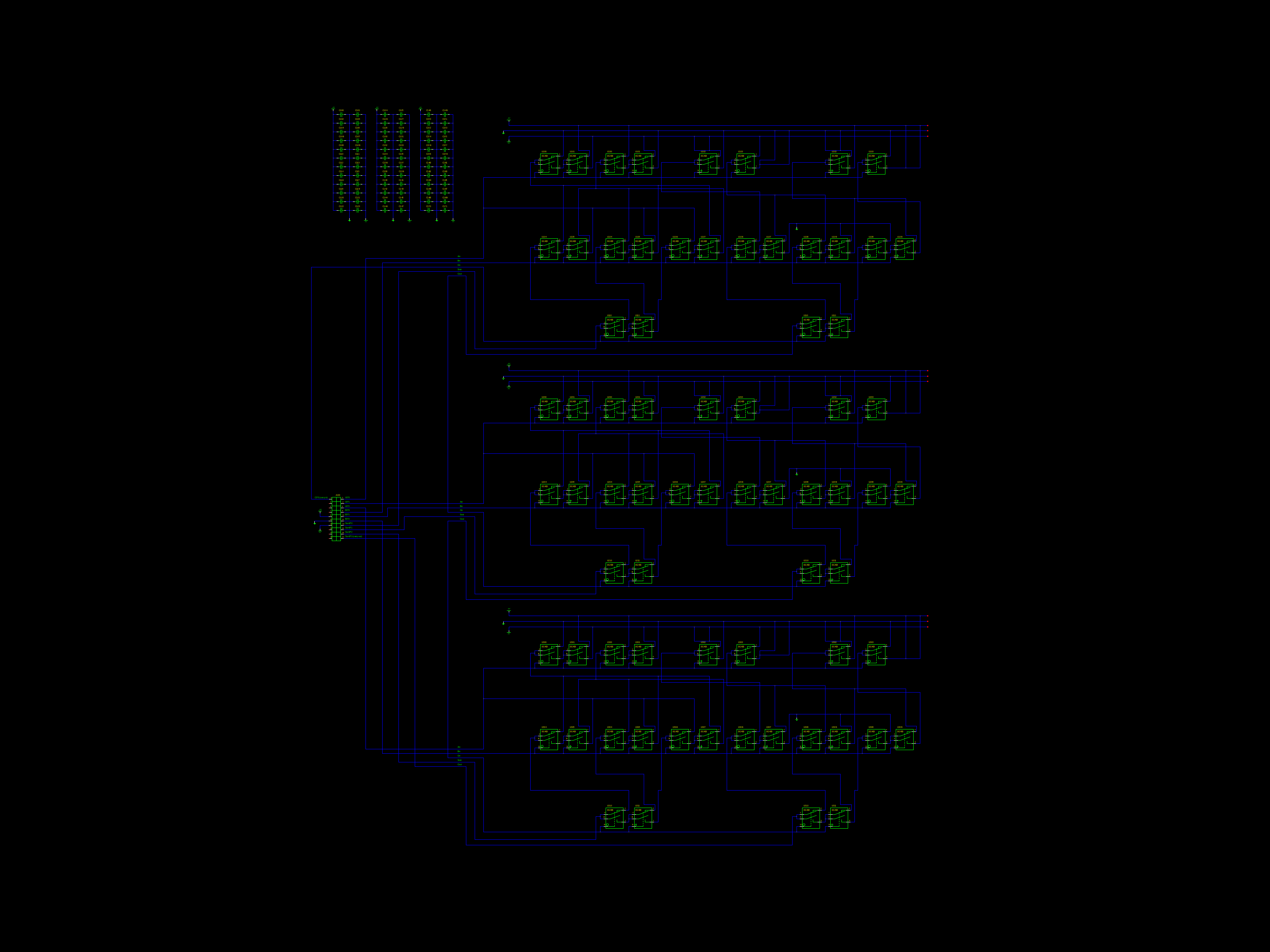

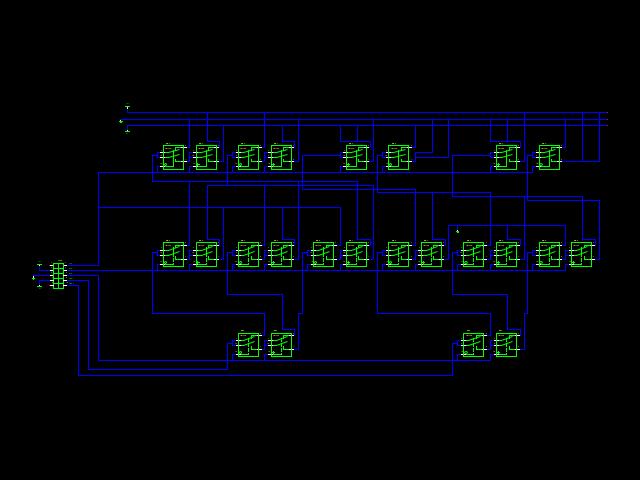

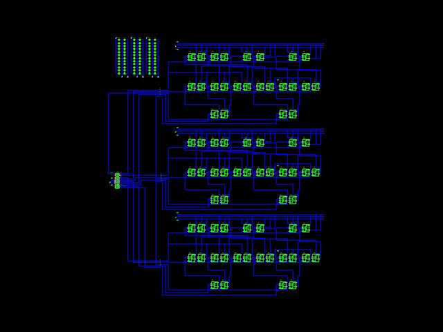

These are exported schematics from that archive (images are clickable):
Level triggered ternary latch:
1-trit full adder:
3-trit ripple carry adder:
P.S. Copyright jay4th under GPLv3

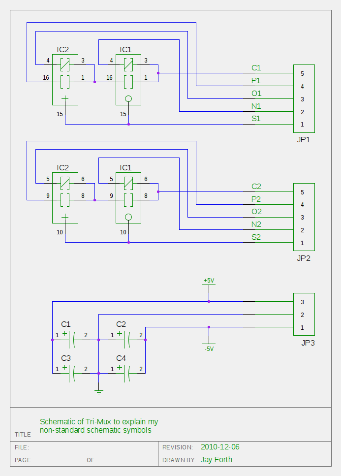

I drew this schematic (the very first) as a way to explain my non-standard use of ladder logic symbols to represent DG403 and similar CMOS switches. From lader logic --[ ]-- represents a normally open switch, and --[/]-- a normally closed one. (Goolge btw translates Russian references to 'keys' when I would say 'switch' in English.) Then in place of a ladder logic coil, which we normally think of as an output on a single rung of ladder logic, I moved the coil back under the switches where normal relay schematics would draw it. But I put a + or a 0 to represent that a particular 'coil' is 'energized' when the voltage is in the + level, or in the 0 level (or above).
I think this diagram style is clearer and more concise than the alternative which I used in the first of the next few diagrams.
The actual circuit is exactly the one Shaos presented earlier. If there are differences it is a mistake on my part, not an innovation.

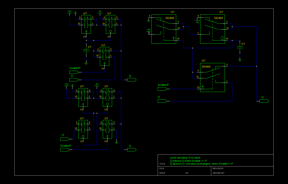

The second schematic shows the same design for a D-tri-latch in two ways, with my 'laderish' symbols, and more tradional 'relayish' ones. The third circuit on that diagram is an alternative design for a D-tri-latch. Note: none of these circuits have been built or tested.
The last two schematics are of a one trit, and a three trit (ripple carry) full adder. Nothing is new or special in them, they are very straightforward implementations as just a simple network of MUXes (with 4 optimizations where a MUX computes a function of the form xyy or xxy.)
The tar file includes circuit board layouts for the one trit and the three trit adder, again nothing has been built or tested. Soon... I have a job now sometime soon I'll have money to play with electronics. For now I play with free software. I am most interested in testing/developing the latch designs, would love to hear from folks that experiment with building these or similar circuits.
