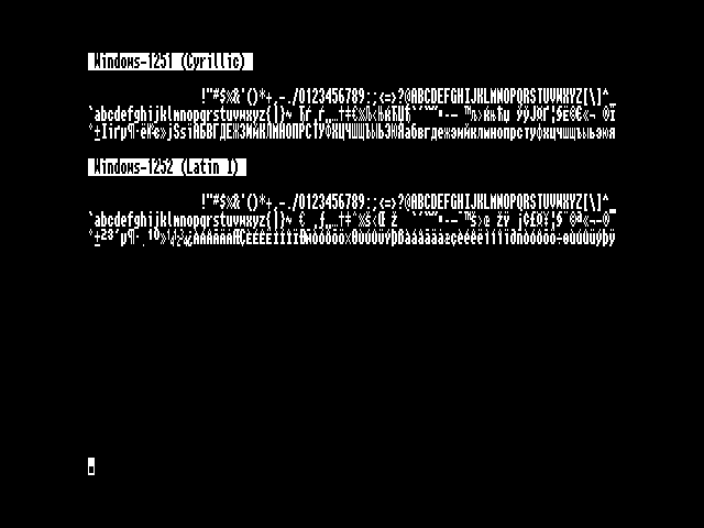

I was going over the download stats for OpenSE BASIC today and it seems that the majority of downloads originated from Russia. So I figured I should let people know that there is a new version, targeted at the Chloe 280SE reference machine (mostly emulated in FUSE and EightyOne as the ZX Spectrum SE). I was going to sign up to zx.pk.ru, but apparently registrations are not allowed any more, so here I am.
SE Basic IV is a 32K ROM and includes a hi-res 80x24 text mode. It uses a Spectrum SE-only mode: 512x192 mode in the 128 shadow video bank. This makes it possible to load a 1K font definition immediately after the ROM to provide code page support. So by way of thanks to all my Cyrillic using users, today I added Windows-1251 code page support. It looks like this:

ROM1 works as an independent 16K ROM and will work on any ZX Spectrum compatible. However, ROM0 which provides the 80 column routines requires the Spectrum SE hardware. You can still use 8-bit fonts with the normal ROM but you'd need to reserve 1792 bytes for the font definition and change the CHARS system variable. You can simply add the code page binary to the Chloe font binary to generate the required font file.

As all the TR-DOS entry points that I'm aware of are in the font area they should work fine with the dual ROM system, given that both ROMs have a font in the expected area.
