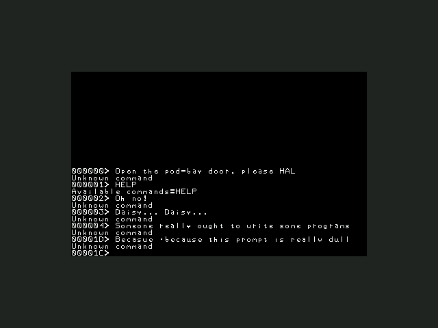

Ok, eventually I've got the time to build this package, but after launch I get black window and this message in stdout:
Tunguska loaded null memory, basically
rendering it a drooling vegetable :-(
It's a lot more fun with something in the
memory to execute...Attempt at accessing memory outside limits
RTI outside BRK
RTI outside BRK
RTI outside BRK

You haven't loaded an image into the memory. Which is comparable to starting your computer with no harddrive. It doesn't know what to do.
Type "make memory", and it will assemble the sources in the "ram/" subdirectory.
From there, you can run "bin/tunguska memory.image", and it will load the freshly created memory.image into the memory, and it will provide at least some interaction.
Also, don't grow too fond of the assembler. I'm working on rewriting it pretty much from scratch, having the excellent GNU tools bison and flex do the parsing (it will mean a slight change in syntax as well). In the end, this will make the assembler much more powerful and flexible than it currently is.
It really was never intended to do half the stuff I've convinced it to do, so this rewrite really is for the best.

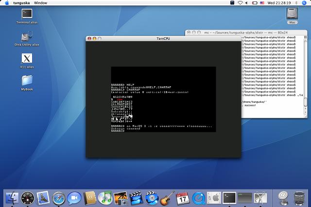

P.S. I've just built tunguska-alpha-1 for Windows using CygWin if somebody needs it:
http://nedopc.org/ternary/tunguska/tung ... -1-win.zip (955K)
SDL.dll and cygwin1.dll are included.
Also I created couple BAT-files to build new memory.image (prebuilt version is already there) and to launch "tunguska" with current memory.image
P.P.S. It's even working in WINE ;)
P.P.P.S. I built it for MacOS X 10.4 (PowerPC) also, but with some small tricks:
1) machine::brk() should be public
2) strndup should be defined in assembler.cc
3) main() should have return 0 at the end (assembler.cc)
