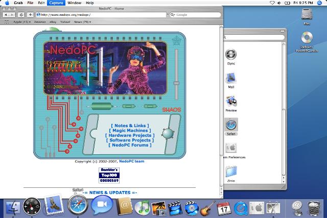

Ustanovil MacOS X 10.4 urezav Mac-partition do 20Gb:
P.S. Pishu ottuda ;)
