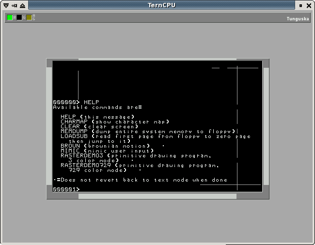

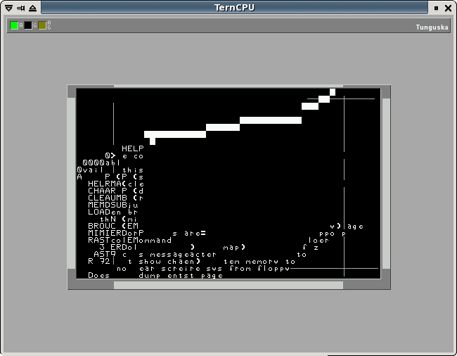

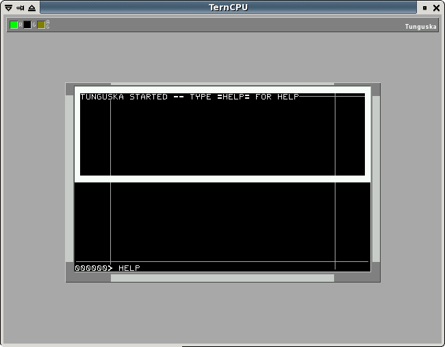

- Posts: 25401
Re: Tunguska the ternary emulator
Before scrolling:eudoxie wrote: Can you elaborate, how does the scrolling look?
Scrolling in progress:
Result looks fine (except broken lines):
